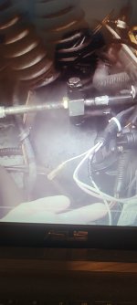

Is there a special adapter to use the test lead the white lead that's on the motor for RPM
Pdevito
Mar 22, 2022
103
Yes my question is the white lead for the test rpm. Do I use my probes and put the red in there and the black to ground. I have the clamp on for the spark plug wire but it fluctuates. Between 800 and 720 I am wondering if I use the white wire with the connecter will it be more accurate and steady. Everyone on iboats has been a great experience so far.

Ayuh,..... What motor are you workin' on,..??
What year is it,..??
