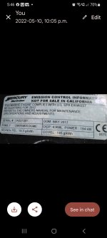

Need your engine serial number to help confirm yours has these items but you may want to try thoroughly inspecting the thermostat poppet valve and especially exhaust check valves at the bottom as they have been found to make the engine run hot if not working properly.
Item 11 and 15,

Item number 19,
Item 11 and 15,

Item number 19,
