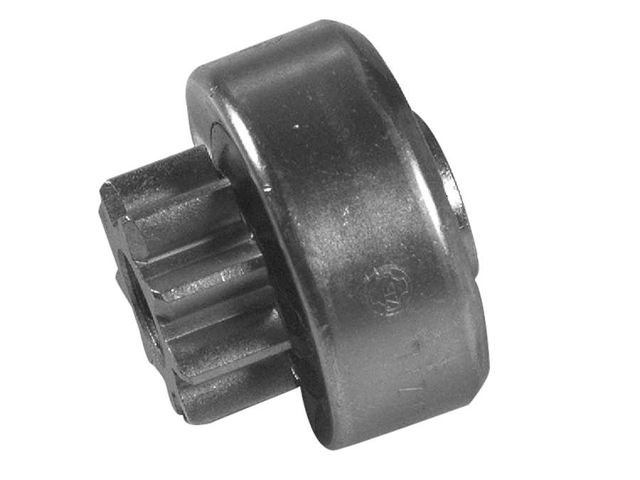

I finally got around to inspecting the starter, looks like it needs a new pinion / Bendix gear. The inside bushing is worn and falling apart. Anyone know where I can get a replacement, Im running into dead ends.

This parts breakdown of the starter should get you by with other parts if needed, https://www.mercruiserparts.com/bam/subassembly/32845/6993/60
68575T 2PINION (1 required per assembly)
68575T 2 - PINION             NLA
68575T 2
About Mercury Marine
OEM Part
68575T 2 - PINION NLA [ More info ]
Unavailable
STARTER DRIVE DV365
DV365
About Arco Electrical Products
OEM Match
DV365 - Starter Drive [ More info ]
Add to shopping cart
Pinion 68575T2​
NO LONGER AVAILABLE
This product is not being produced anymore however may still be available through other dealers.
