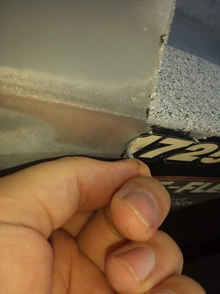

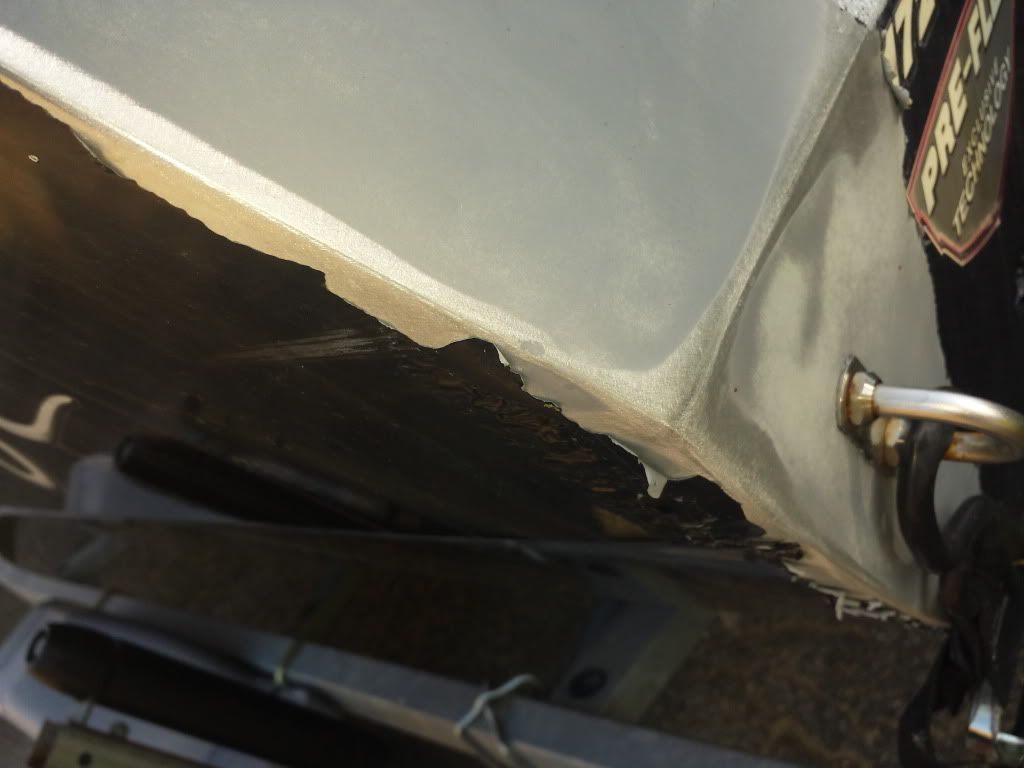

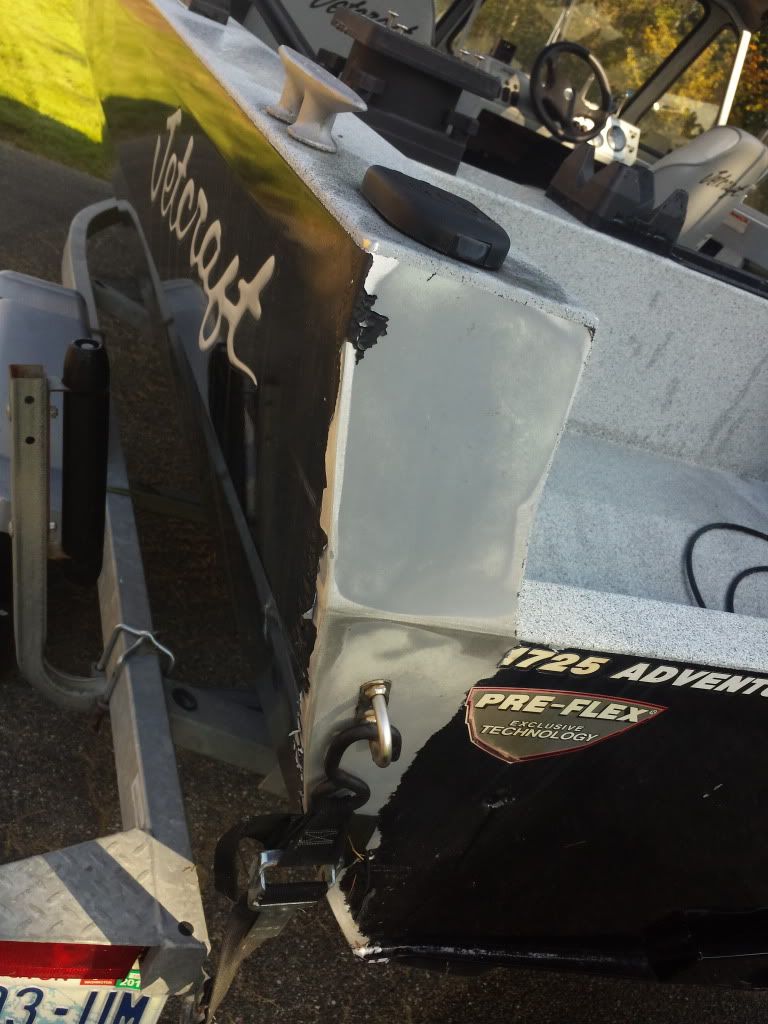

Pictures below. It looks like the primer is still on there because i can see a flat grey spot, i assume thats the primer, and than brushed aluminum.

That should be a warranty repair but it's been 5 years. I wonder if Jetcraft will step up? I know a lady who owns a nice little 20 foot North River that developed a pretty bad leak from a hull crack and the newly organized North River company fixed it for free even though her boat is about the same age as yours.
