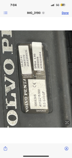

5.0GXI-GF and has 555 ECM and HSV distributor
