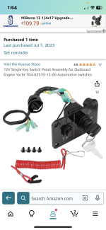

Not sure if it matters, but the ignition switch you ordered and installed is for a motorcycle! I don't think it will have a "press to choke" feature and I'm not sure what else might be different. Maybe the wire colors are different. Not sure why you ordered a motorcycle ignition switch.
cluless74
Jul 6, 2023
7
