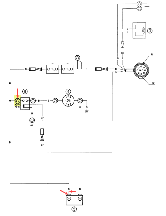

3. Voltage drop test. Voltage 12+ at each testing point with voltage drop test coming out at zero all the way back to the Starter Solenoid relay.
The fact that your getting no voltage drop at all is suspicious in itself. Usually drops below 12 volts when cranking.
Suggest you check the voltage drop at the battery side of the relay while cranking.

Okay, these are my results with the battery side of the relay.
cold = 13.66
cranked = 4.62 then climbs to 6.5ish
I'm not sure what this means as I am not electrically(?) inclined. I did remove the key switch and it has a voltage drop of zero. The YouTube video I watched to do this indicated this means the switch is good. Any ideas on the next steps to take?
cold = 13.66
What does "cold" mean?
Fully charged battery voltage is 12.7 volts. Can't get to 13.66V w/o the motor running?
You either have a bad battery, a dirty battery connection or bad battery cable

Voltage drop can result due to poor electrical connections or an internal problem within a wire. The battery may be defective as well.
Start with testing the voltage at the positive battery post. Then measure the voltage at the positive terminal of the battery cable, at the battery. Then measure the voltage of the battery cable at the starter relay.
Measure the voltage with the motor being cranked of course.
