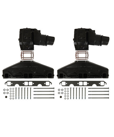

I looked again at the pic of the manifold/elbow joint & you can see moisture oozing out. Def a problem there! You don’t want clogged elbows etc but also if they are leaking on the inside that can put water in cyls; rust exhaust valves etc.

If these thunderstorms quit for a while I am going to get sea tow to take me dock to dock from the marina to my boat ramp so I can put it on the trailer and take it to my driveway where I have access to all my tools. I see what you see Lou so I will pull the risers off and take pics... and no matter what... get a new impeller like Scott recommended. I still have the original VP Raw water pump housing that I replaced with the Amazon one... so I will inspect that and if in good condition use the new impeller on that and swap it out the entire Amazon one with the original VP raw water pump and new Johnson or VP impeller. I did purchase a circulating pump from Amazon but it says it is made in USA, and is OE Mercruiser with Bronze impeller... I paid a little more... but I "think" this one is safe... Might as well cover all bases. Will update a little later thank you both I appreciate the help.
Yep my eyes are not what they used to be... I do see drops on that Pic.

Also found the Barr Mani and Risers here
A little over 1119 + 50 shipping... and also there's an option to pay using Amazon so hopefully at check out I can use the instalment plan. I haven't placed the order yet because I just got the boat in the driveway and there are 2 different exhaust sizes 1 is 4" and the other is 3 3/4" so I need to measure to see which ones I order. Will pull a riser tomorrow and post pics also.
