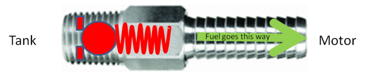

Did you in inspect the anti siphon valve?
I had this problem on my '88 FW H-200 years back. Replaced with a better quality one and no problems since.
I hooked up an external tank with a primer bulb straight to fuel pump and had same problem
