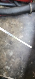

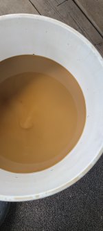

I drained the new oil that I used to flush the system into the same bucket so it's darker than it did look. The dipstick pic is the color it was.
KJM
Lieutenant
Jul 31, 2016
1,277
You need to at least get the old milky oil out of her, take out the plugs and get what you can out of the cylinders and put some fogging oil in there. Letting her sit with water in the engine is not good. I had a similar problem one time, turned out ti be a tiny hole in the exhaust manifolds.
