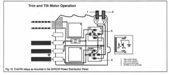

2000 Evinrude 225hp motor tilt trim will not operate. The PDP has been rebuilt, relays work when switch is pressed both ways, power down to the motor, motor works when connected to a 12v battery source.
What else could be the problem. Could it be the trim sending unit, trim limit switch?

what does ... "power down to the motor" mean ?
are you saying power is sent down to the motor when you activate up or down toggle switches and yet the motor does not work ? and yet the motor runs ok if fed direct battery voltage on the wires going into the motor.
trimming draws lots of amps and all the relays do is feed bat and grd one way and reverse the other way.... relays may click ok but any resistive path on the B+ supply may supply enough juice for relays to click but fail to deliver big amps for the motor itself.
check all connection points, check the fuse pins and socket for oxydation . The fuse gets +12 of the solenoid. check those connections also.

that says the battery wiring to engine ground and solenoid /starter are ok and....will carry enough amps for the trim motor .........when the wiring /relays are fixed. check any interupt devices or bypass them tempotarily as a test .
open all connectors to the front controls/display if any trim should work by itself withouthe front controls on the throttle/shifter
focus on the rest of the wiring ex: solenoid connection feed to the relay block assembly
and relay block wires to the trim motor connector, relay socketsand relay pin contacts. etc...
see basic 2 wire trim

btw what was wrong with your PDP ?? the bottom D input feed of 12v has a history of cracked or cold solder joint easy to reweld if you are handy at this.
since your T&T relays get their +12 source directly off the PDP it is possible your PDP is still defective. It may let enough +12 to be distributed for lesser amperage hungry ept...but not your T&T motor. see if anything happens if you tap the panel itself while trying to trim.
here is a better shot and has you can see there is not much between a strong +12 DC input at "D" and output of DC and GRD distrubution ..... from the relays to the trim leads.
