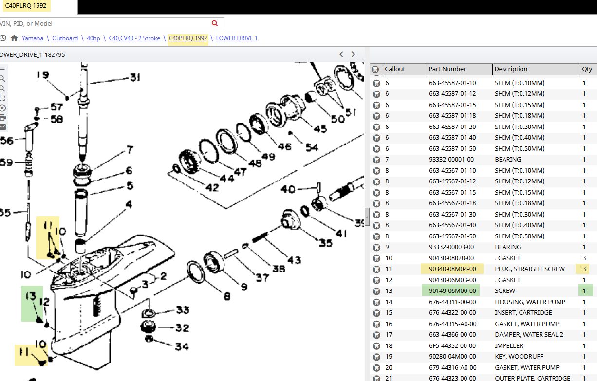

Picture in post #7.------The plug at the lower ( second from the bottom ) front may have something to do with the shift mechanism.

Shift Mechanism, interesting. When I can I will remove the plug and peek inside to see if/how it aligns with the shifter.

The center plug does align with the shifter wedge, probably more towards it's top but I couldn't tell by looking into it because it's so small. The plug itself is smaller than the top and bottom ones and is the magnetic plug.
