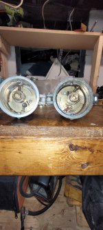

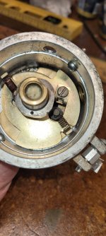

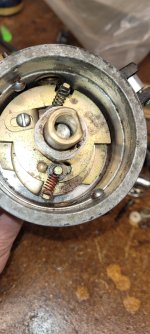

I acquired another distributor and noticed the springs are much lighter and advance stop is totally different than the one in my engine currently.
Being the same distributor why would these be different?
The second picture is what is currently in the engine.
Thanks 😊

Because over the past 35 years, someone changed the springs on either your distributor or the new one you just got
53,089
Spring rate and weights determines the advance rate.
