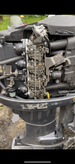

So, have a 1998 Yamaha 50 hp 4 stroke. It ran great once….. went to start it, and it took over an hour to get it to run. Now, I can only get it to pop. Here’s the rundown of all I’ve checked…..
Compression is good, all cylinders within 2 psi of each other.
Rebuilt carbs
Replaced all fuel lines
New fuel pump
New plugs
New starter/solenoid
Now, I have checked spark, I have compression, and I have fuel. This is the electric choke model and it’s also a remote controlled unit (not a tiller). I am at a loss, what do I check next? Never seen something that wouldn’t start with fuel, spark, and Compression. Added a photo of the carb setup for reference. Thanks in advance! Almost at my Witt’s end!
