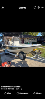

Im considering buying this boat. it’s a 98 bay quest. Has only 97 hours on boat and motor. what can yall tell me about these boats? i did a little research and it’s a composite build no wood.

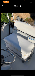

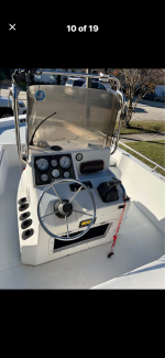

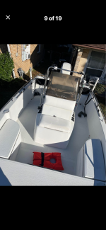

I can't see any obvious damage, looks like it was taken care of fairly well. It looks like the backrest on the driver's seat will need new wood, and probably the seat too. The black is pretty dull, lots of hard water? The weird spottyness on the plastic windshield is normal.

As with any boat, look at condition of flotation material, is it water logged??
Is the hull interior holding any water.

Maybe. The vinyl doesn't look bad, it's just the wood backing that's rotten. Any water that soaks into that foam will just sit there pressed up against the wood for ever. It could be that just a bit of water got to it.
The boat looks too clean for outside storage. No water streaks, mold or algae growing in the textured areas, I don't see a bunch of debris built up in the windshield.

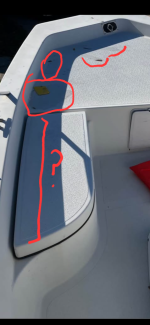

However, I did just notice the bondo spreader in the last picture, along with several filled areas. I wonder what that is all about.

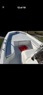

Could you actually see the transom from the inside? That could all be cosmetic. Obviously the cracks are concerning, but it's all in pretty common areas, could be mostly air void cracks. The drain plug is just somone who doesn't know how to use silicone, easily cleaned off and fixed.
It would be a gamble on wether the cracks are cosmetic or deeper damage, but I'm not too concerned.

It wasn’t a chance I was willing to take. I can tell the guys didn’t take care of the boat. he ran it with External fuel because he said the internal fuel tank didn’t have no gas which i found odd. I popped the latch for the internal fuel tank and found out it was aluminum. So there was a possible leak and no way for me to know. In the inside, the boat on the deck had cracks and holes in it.
