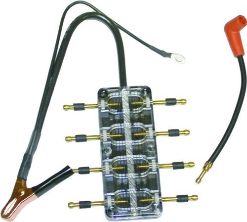

Re: 1998 Merc, OFFSHORE, FUEL / CARB QUESTION .. Please help.
CharlieB
Apr 10, 2007
5,617
That is the PERFECT tool for checking spark.
Mine is soo old the top two screws are used to keep the center ground attached, and the clear plastic is (?) faded (?) needs to be buffed out clear again so I can see the gap!
Sunfish12
Feb 6, 2011
260
Where do you find a spark tester like that?
