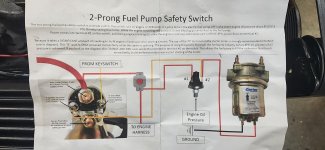

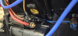

Need a bit of help guys. I understand needing the oil pressure switch to control power to the new electric fuel pump, and tying it in to the starter circuit, however this starter only has 2 terminals instead of 3. How can I work around this and still have power to the pump when the engine is cranking? Thanks!

You could install a solenoid with the correct # of terminals. What you have is the 3 terminal style but what you need is the 4 terminal style.

The oil pressure switch included with the kit, only has 2 terminals instead of 3. Guess I need to get a replacement? Where would I find one?

Saw that one. The Carter A68301 switch has 1/8NPT threads so I won't need an adapter, and it has better reviews as well.
Thanks for your help guys!
