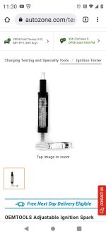

Update... Bought spark plug tester. Found no spark on 1 cylinder. Tested ignition coils and found low resistance on a 3 month old coil.
Trying again in the water this weekend.
Thanks for the advice
