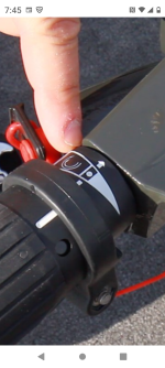

So hard to tell since it’s a bit faded off the tiller. See the photos below. The first photo shows a bit of white which lands at full throttle don’t know if this is start position?

Pretty worn but I can see it though. Right now your at the shift position. See the arrows on each side of the small circle? Next larger circle is the start circle. Represents a pull cord. International symbols instead of words. That is where the throttle should be especially when cold. Turn it down before you shift to avoid clunking.
