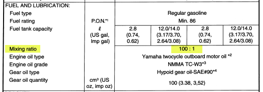

Older is somewhat subjective, but one of the last small two stroke models offered by Yamaha in 2009 specifies 100-1.
