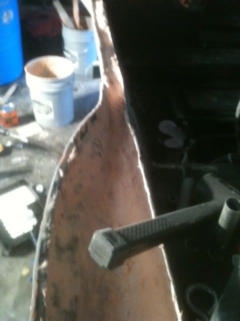

I have thought about the plywood core but the more I think about it ...I do not want there to be any wood back there to ever rot ...but the weight still concerns me a little .....
Also in this picture you can see how the outer skin is cracked along the bottom and sides of the motor mout ....what would be the best way to attack that for the repair...should I cut the inner skin out and repair from the inside or should I repair form the outside or both ...I was thinking about the inside repair with a few layers of mat and the the crack on the outside will be fillied in with peanut butter and then when the motor is mounted back I can seal the mount to the outer skin with silicone ...what are you guys thoughts on this ....

still going at it ...trying to get all of the wood out of the transom so I have a good skin for the nida bond to adhear too.....

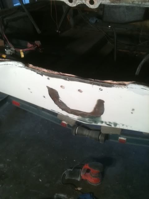

ok well I have been steadily workin on th is little beast and here is where I'm at so far .....
I reglassed the rear outer skin of the transom and got it all nice and smooth

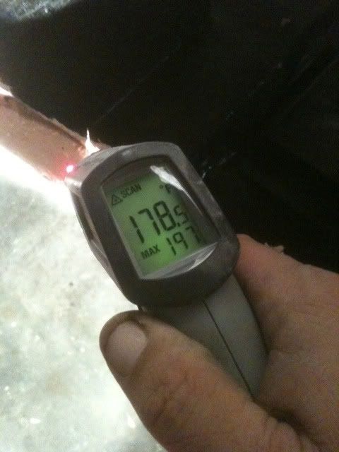

and boy did it get hot
all in all it was a very straight forward mix...just follow the directions that they send you and you can't go wrong...
The transom is very very very solid now ...it has been curing for 3 days and this thing is solid
I have now got my first coat of prekote on and it's looking very good ...I am planning on trying to get the first coat of interlux brightside on later tonight

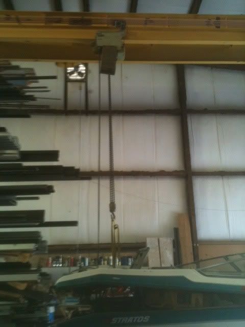

oh and if you dont have one of these ...you need to get one ...it makes lifting the cap off and on much easier
