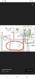

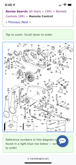

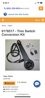

I’d like to tap the knowledge of this thread. I am adding power tilt trim to my 91 Johnson J50JEI. I am ordering all of the parts right now.
Below is a picture of the handle cover and wiring I’ll buy, a diagram, and my control box. What does connector 71/72 plug into?

Honorary Supreme Mariner
39,949
It plugs into a wire that goes to the motor wiring.----Should be easy to figure out if read all the posts in this thread.-----You must be kidding if you are willing to buy new parts for that kind of money.
