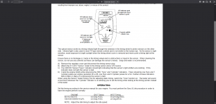

The PDF on the tester I found at CDI not only had the operational description of the tester, it also listed the timing specifications for my engine!!
Here is a photo of that PDF

No the analyzer is used to time the engine!!! I have the exact same motor with the factory manual.
