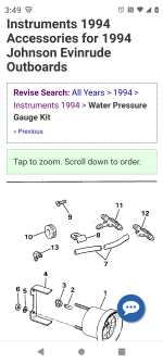

By the way, motor doesn't come with the pressure sending port for the head, it comes in a kit with the pressure gauge. Your right, someone probably removed it.
saltchuckmatt
Jul 19, 2019
3,289
Just looked up your engine, part 13 says it's mounted on the exhaust cover. Look for a small 90 there.

Rusty bolt is one of 3 that holds an assembly with 2 thermostats and 2 poppit valves.----Important parts of the cooling circuit.---And absolutely not the spot for a pressure gauge !!------I suggest that you post compression test results.-----These motors are nearly world famous for broken piston rings.-----Yes , those are the trim relays.

Moving the tell tale to the top of the engine was on certain 3 cylinder motors. ---Does not apply to your motor !!----Post #10 shows how a factory pressure gauge would be installed.
