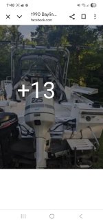

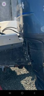

Here is a few issues saw
cyclops222
Mar 21, 2024
3,218
Just make sure the motor can TILT UP all the way and you can remove the top cover of the motor for servicing.
