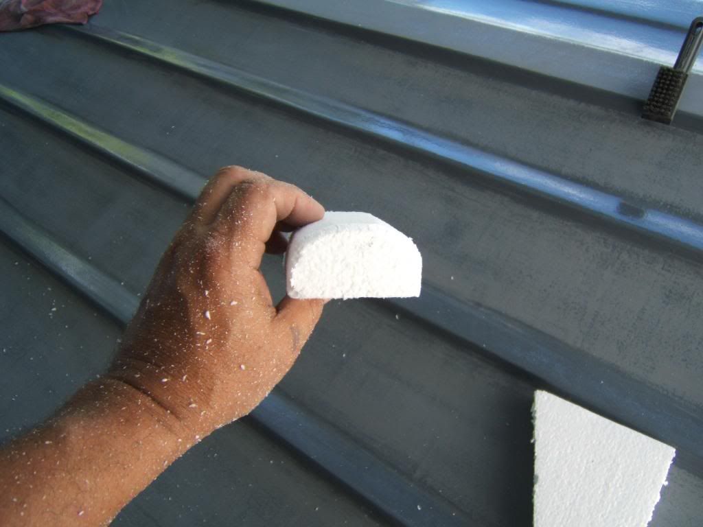

Yesterday evening I pulled out the DA with 60 grit and sanded all my areas down past what I hope was the top layer of original gel by removing most of the ill-matched patching. mixed up the best matched batch yet, and sprayed it on pretty thick. I've got one flat area on the bottom of the hull that had some cracking, but most of the areas of repair are curved so I think the long board is out (except flat area) because it will probably flatten out these curves and remove too much of my newly sprayed top coat. my biggest repaired areas is the flat spot on the bottom (gel was cracked all the way to the glass) and one of the keels. It really is a pain to try to match the original contours but I got it as good as I can... we'll see. SO tonight when I go to sand should I use the DA or hand sand with short boards (12") or a foam backed auto body sanding blocks (8" and 6"). What I have for sanding now is an electric HF DA (I've used it with water and so far so good) 60 grit, 100, 220, and I can cut 320, 400, 600, 800, 1000, and 1500 to fit. I have a piece of 2x4 set up at about 12" using the wide side, 1 piece cut down to about 2 1/2 inches wide 12" long and these
can I use any of these to get it smooth? I am waiting on a roll of 1000 grit to show up once that happens I can make a 2x4 board as long as I need it.

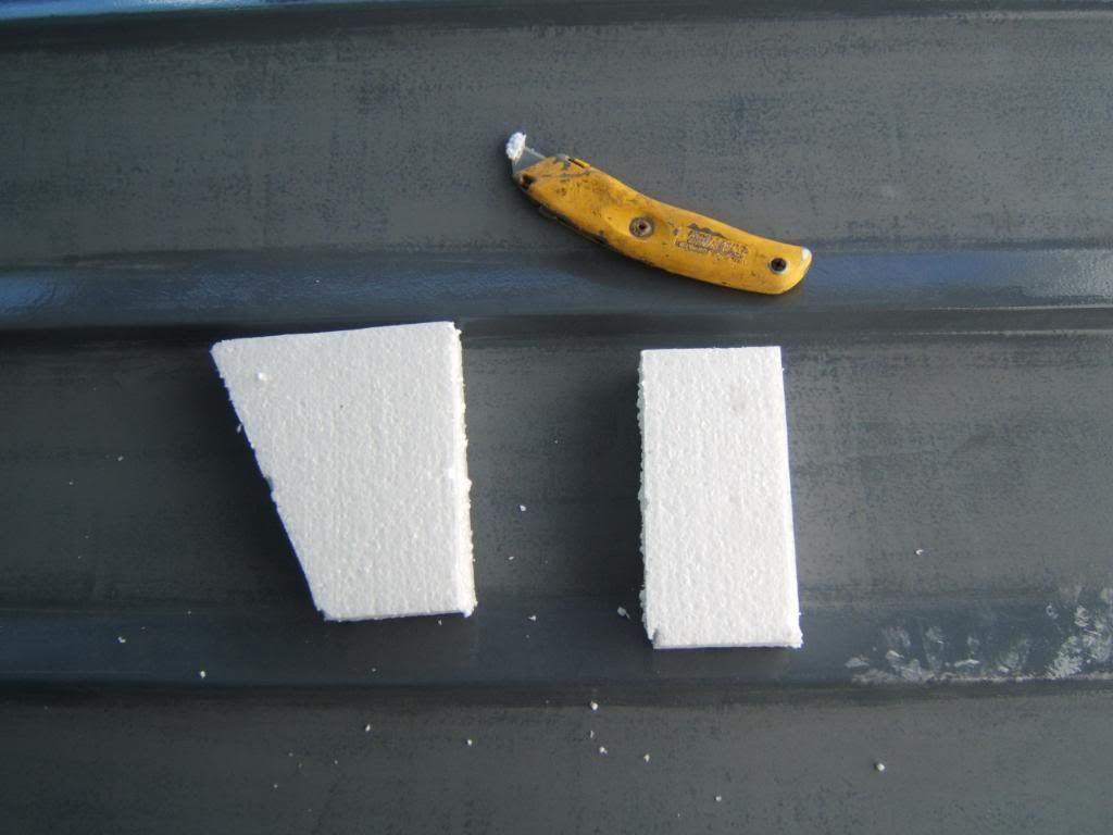

Depending on how flat the hull really is, you can use any of the sanding blocks you have pictured or you can make your "soft" sanding blocks out of some EPS [aka, white bead styrofoam]
You can shape them into whatever size/contour you need...I used the wire brush in the pic to unclog the sandpaper when it got loaded...
When you get into the wet sanding, use some soapy water as a lubricant and rinse frequently with water...
