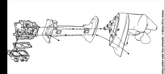

I have a water pump kit in route, but not here yet. Service manual shows a discharge up high, which I assume is the 4 holes, then more water discharging below the cavitation plate. The water from the 4 holes was more of a trickling, not even really a spray. I've never had an outboard this small... maybe it's normal??
You will need a new kill switch part number 75 on this part list. Not always fun to replace by the way.
Can't believe they didn't put a tell tail on a 93 but maybe. I'm working on an older 4 hp and really there is now way to tell. Check head temp or pull and make a visual on the impeller.

See my video I just posted. I don't see a telltale, but not 100% what I'm looking for since the water flow schematic shows it from the side only.
