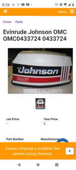

Does the cowling look like this except a 35?
No it does not. It Has a narrow red bar all the way around it and a black narrow bar below the red bar all the way around it, and has the name Johnson above the red bar on the side near the rear of the motor with a little horse trademark right in front of the name Johnson. Sorry, I tried to post a photo on here but I just cannot do it.

it looks like an 83 model. look on the transom bracket for a tag. Otherwise look on the powerhead near the head for a silver disc with #s on it
