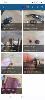

Still got a few......PM if interested. Briggs & Stratton part# 398188. Not a problem if you are in the lower 48. And you only need two (2).
gica
Feb 24, 2016
582
Is the thumb picture the 398188 seal? And it takes 2?

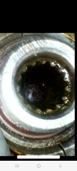

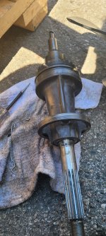

OK so I pulled the drive and before I did that. I drained the liquid Inside and surprise surprise there was water with a little bit Of fluid luckily it was only lake water. I removed the propeller and the shaft inside I didn't see any rust
I looked at the spines in the crankshaft and they look fine.
I saw o rings In several places Including the lower shaft.
Now when I when I lower the gear link Rod And spin the propeller It seems to engage the main Shaft

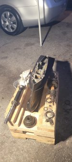

So I took the drive apart. Need some bearings and seals

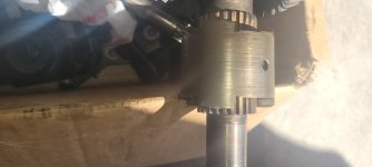

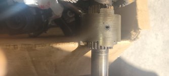

Now when you have the LU apart check the clutch dog.
It is the clutch dog that make the shifting from forward and reverse and vice versa.
The edges at the clutch dog teeth should be sharp and perpendicular not rounded.
If they are rounded it maybe slip out of gear under load.

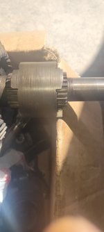

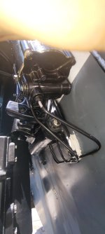

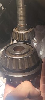

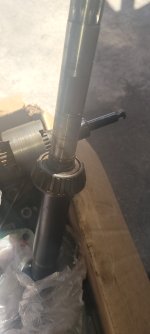

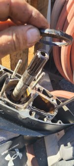

So there are 2 bearings one on the main shaft which was definitly full of crud and the other attached to the reverse gear don't know if it is salvageable.
That one is big. I cannot find a part number for it. Any ideas?
Here are pics of the bearings and clutch dog(I think)
