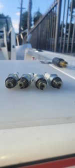

Another picture of the plugs.
Do it ran great for awhile and then it suddenly stopped, it would stary right up but sometimes there was a bit of backfire when cranking. I did start it a few 10 times and it seems to be ok now. I was like wtf this is new. So I raised the front of the boat more and it worked fine. Lowered it again and it did not do it. I took off the hose from the tank to the first junction and trimmed the ends. I took off the fuel sender and looked in the tank there is fuel there. It shows quarter tank on the gauge.
