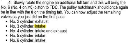

OK, I finally had some time to work on the old boat again and I starter her up with earmuffs and the heard some slight ticking. I also noticed I have the plastic lifter brace so I tried the 1995 method and with ear muffs she sounded great so I took her out to the lake and did a couple 500 yard runs. The 1st run was great but on the way back it did a small backfire(hoping I didn't mess anything up). I tore her down last night and did the 1990 lash plus 1 turn but I came onto a miss print that I think affected my original test with lash plus 1 turn. See attached 2 pages from the manual, it has #3 cylinder "intake" twice and no exhaust. I was trying to figure it out myself and at TDC on #3 with lash plus a turn the nut goes all the way down to the 1/2 round washer but all other cylinders the nut is just on with maybe 1-2 threads showing on top of the nut & not close to the 1/2 round washer.
Also curious how much oil comes out of other 4.3 rockers? Mine does about 1 drop a stroke even when brought up to 2000rpm & it doesn't seem like much.
Again sorry for the novice questions but this is new to me. This boat has been in and out of shops for 1 year, nickel & diming me & I just want to get it back on the water.

It's a misprint
Me I pay no attention to books for valves. Turn motor until intake or exhaust is down. Then adjust the opposite valve that is not down. Mark with grease pencil and rotate some more until all have been marked
