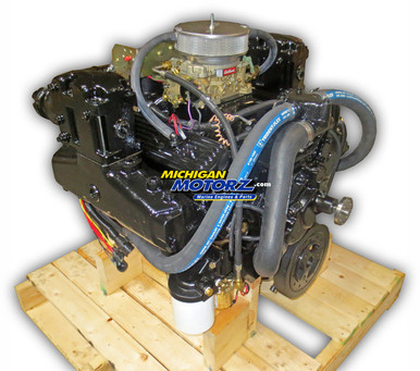

entirely possible if engine was replaced with a partial engine over the years it is not in the factory Merc location.
If you look at the photos of the rear of the engine in this partial engine package there is a bracket between distributor and carb where they are located in a lot of non OEM replacement engine packages. May be there and hidden ?
