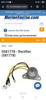

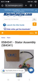

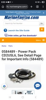

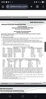

Hey all. Having problems testing for correct issue on this motor. I've looked up what I believe is the correct page in the CDI manual (screen shot included), but none of the wire colors seem to match up. I have also checked wire color verses pictures of original parts from parts manual and my wire colors do look correct.

Power pack calls for part# 584489 but I have part#583656. My wire colors are:
Orange/blue stripe
Orange/green stripe
Tan (brown?)
Black
Black/yellow stripe
Stator part number calls for 584341. I have not removed mine, but didn't see a part number anywhere on it. My wire colors are:
Yellow
Yellow/gray(white?) stripe
Yellow/blue stripe
Rectifier calls for part # 581778. Wire colors are:
Yellow
Red
Yellow/blue spark.

Agree. But where do I find correct resistance readings for my specific unit. it seems what I found on CDI manual doesn't line up with my wire colors unless I am completely misunderstanding...

You made this statement..." my wire colors do look correct " max rules has color charts but you already must know.
Continuity test on wires should come out with 0 resistance. Resistants for your stator coil will be listed online.

I was saying they look correct when compared to pictures of OEM parts off marineengine.com parts manual. But they do not line up with the colors listed in the CDI manual that I posted a screenshot of.
If you mean online as far as the CDI manual, I've got that, but not the same wire colors I am seeing as I posted in pictures.

I thought CDI was indicating that power pack could be tested. The smaller power pack plugs into the bigger power pack with no wires leading elsewhere. Figured this out after pulling flywheel and removing all components to find the brown and brown/yellow under that smaller pack. was able to test those and came up with correct resistance (500-650 ohms) according to CDI manual. I cannot find the 'trigger' wires though. CDI calls for a black/white and white/black wire - but I do not see those anywhere coming from any component coming from under the flywheel.

Charge coil is the smaller coil with only two wires. Correct? If so, that tested out with correct ohms of 550 brown to brown/yellow.

The trigger is part of the powerpack.----Install the conversion kit and go fishing.

The only thing I have been able to rule out so far is the ignition coil tests as it should (though it does have some cracks and I'm replacing as a preventative measure since it's only $30 or so) and the rectifier is definitely bad as evidenced by a bad wire that was damaged almost all the way back to the rectifier itself. But, if what I've read online is correct, unhooking the rectifier should still allow the ignition system to function properly - is that correct?
How would I test the stator? Can't seem to find correct info based on my wire colors.

Here is the Sierra conversion kit: https://www.marineengine.com/newparts/part_details.php?pnum=SIE18-99213
What is the benefit of the conversion kit verses just replacing the power pack?
I'm really wanting to learn more about diagnosing these things - partially because I enjoy learning, partially because I hate replacing parts that I haven't proven bad, and partially cause I'm just hard headed. How can I prove the power pack as bad with my meter before replacing?
