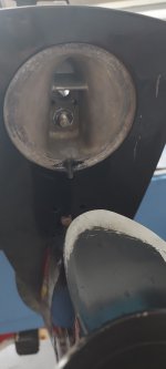

I have not used boat in 2 years, I have changed the water pump before, so I know it has a half moon shift linkage. And 4 bolts. But now it is not wanting to drop the lower unit like something inside is holding it from dropping more than a 1/4 of an inch.... help I have I idea how to free it up to drop off so I can change water pump and lower gear oil

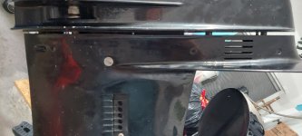

Couple of plastic wedges that you would use in cutting down a tree ???

The 2 trapped Nuts can be utilized to push the housing down. I would put something between the nut and the house, just to prevent the nut from Machining the housing

Oil and water pump. I tried the bolts to push it down. Will add a spacer to add to it
