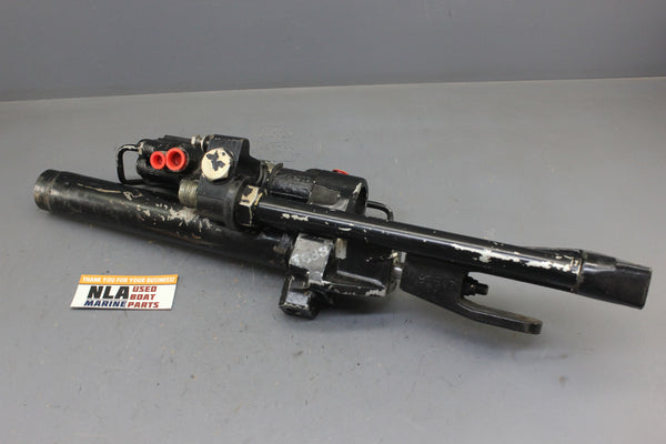

Just ran out and checked and after looking at a few threads, I don't think mine has the flats. It's the older style and the tube for the steering cable is all round with a nut at the inner portion where it attaches to the stud arm.
I've attached a link to one that looks like mine

Did you ever find out your problem? Or did you end up having to replace the Power steering actuator? Mine is leaking and the only replacements I can find are over $1100.
Someone out there has to be able to rebuild these or there must be another replacement part out there that works that isnt that expensive.
I have searched all over and cant find any shop on the internet that claims to rebuild these but I know there has to be someone.

I was told rebuild kits are out there.. old corvette and mustangs used these power steering units. Sooooo i looked on my google machine and have found some information. Im not there yet on my rebuild but my findings say yes you can replace seals and clean it up. Better than spending the bucks on a new or used unit. Good luck
53,227
no. you were told wrong
the actuator is pure mercruiser only.
the power steering pump on the other hand is just a saginaw pump used by nearly everyone ..... ford, GM, chrysler, BMW, mercruiser, VP, etc.
