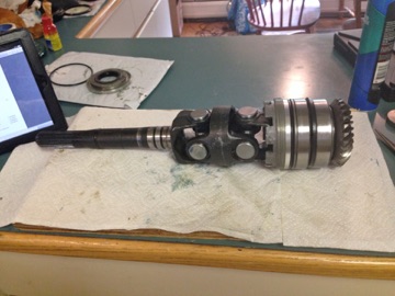

Not sure if you have already started into it . . . but . . . You drain down the gear lube at least a quart and then get the special tool to remove the large castle ring nut that surrounds the yoke.
With a firm pull the drive shaft/bearings/gear will come out. It is going to look like this . . .
Leave the top plate intact. IIRC, you are going to need a rolling torque wrench when you put it all back together. It is best to have the Bravo service manual handy.
