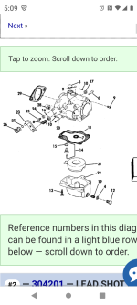

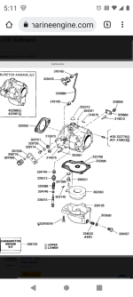

The 88 does not have a idle needle and the 89 does according to the parts breakdown. Also, the 88 has a 49d main jet and the 89 has a 50.

So my question is still not answered will the carbs with the external needle valve work on my 1988 48hp?

I think your showing the wrong carb unless I'm going crazy. 🤨
The top carb I posted is his 89 and it has the side mount idle screw.
