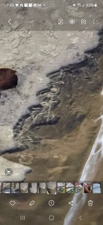

I dont really have to much history on the hull. It seems like the patch is fiberglass though.

I flipped back and forth on what to do with and decided to fix it up. Scraping all of the crap the previous owner had on it before was the hardest part. I used a combination of an angle grinder blow torch scraper and sand blaster to remove all of that. All of the corrosion appeared to be from the outside in due to saltwater being trapped under neath the bottom coating. I filled the very small holes with marine tex. The larger ones I drilled out to 3/16 or 1/8 of an inch and used closed end pop rivets with 5200. There was another section with larger holes in on of my first pictures where the guy ran something over. Patched this by riveting an aluminum plate covered in 5200. The whole bottom got and epoxy barrier coat as well as the transome. I put aluminum non af paint on the bottom as well as painted the top side. I have a lot of interior work I want to do but I want to see how well my repairs hold up first. Water test should be comming in a few weeks.
