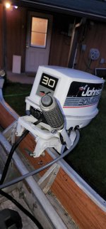

I bought a 30 hp Johnson about a month ago. It ran when I bought it. It sat for about a month after I got it home while I rebuilt the transom. It won't start now. It cranks, but won't turn over. I haven't found any shops willing to work on it. I'm willing to do work myself if I have to. I messaged the guy I bought it from and he said it fired right up every time for him. So I'm hoping it's just something minor, but maybe something broke or shook loose on the transport home. Any advice would be great. I don't even know where to start.

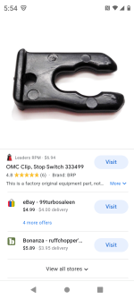

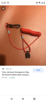

Yes, the kill switch serves two purposes. One, if you push it in it turns off the motor but it also has a little clip in it with a little string that you clip to your body. If it pulls out of there it also kills the motor. If you lost that clip when you transported it it will not start. Do you see a little clip on the end of your handle?

Should be something like these.
I don't have anything like that. The kill switch doesn't feel like it is engaging anything when I push it, either. There is no little click on type feeling

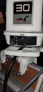

You're right, I was treating it like a choke. So I ran out there and tried what you described and I still couldn't get it to go. My neighbor is in for the night.
I didn't feel much resistance when I pulled out the plunger so I tried a few more pumps. It slowly went in, no snapping action. I attached a picture to make sure we're talking about the same thing lol

You might have flooded it.
Did you have the throttle in the start position?
I believe once you figure it out it will be a piece of cake.

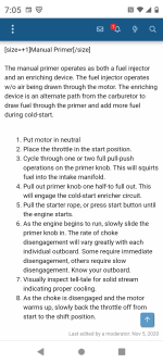

Here is the procedure again, just more detailed.
