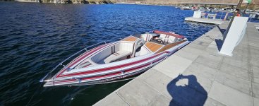

I just bought this boat and it's in really good shape but in need of some repairs, upgrades, and hasn't been run in 14 years. I have ordered a lot of parts and should have them all by weeks end. Then the fun begins.
Work to do
1. Restore gel coat
2. Flush dual fuel tanks, replace fuel lines, fuel pump, fuel filter and carb
3. Find and reinstall dual fuel tank valve and switch (could use some help understanding role of switch in relation to valve and fuel gauge)
4. Install new fuse panel and tune up electrical harness
5. Install new radio head unit
6. Change oil and oil filter
7. Freshen up spark plugs and check gap
8. Change impeller and stern drive gear oil
9. Replace plexiglass windshields
10. Install new batteries (done)
11. Polish sterndrive and install new stickers
12. Change out glovebox and install USB chargers inside glovebox
13. Install new rub rail trim
14. Change out accessory panel and switches
15. Change out gauges
16. Change out ignition key
That's it for now. If I can get all these items done before winter hits....I will store and be ready for spring. Colorado River and all the lakes on it are my playground.
My background. I am a general contractor and self perform most of the work I do. I used to work for Bruce when he was still alive and was operating Conqueat Boats after he sold Sleekcraft. Jim Foley married into my family before he passed.
All that being said, looking for recommendations on the restoration and wiring of the dual tanks switch and fuel gauge. Any pointers and help is much appreciated

I am a little concerned about not having a coast guard capacity plaque on the boat. Not sure where it ever would have been....no signs one was installed but it could have been a sticker and come off a long time ago. Are there any Sleekcraft owners with a Diplomat that can snap a picture of their plaque? I can have one made but I don't want to have to figure out the cubic inches of the boat and what the powerplant weighs.
Any help would me much appreciated.
alldodge
Mar 8, 2009
44,777
Boats less than 20 feet have to have one, those above that do not
