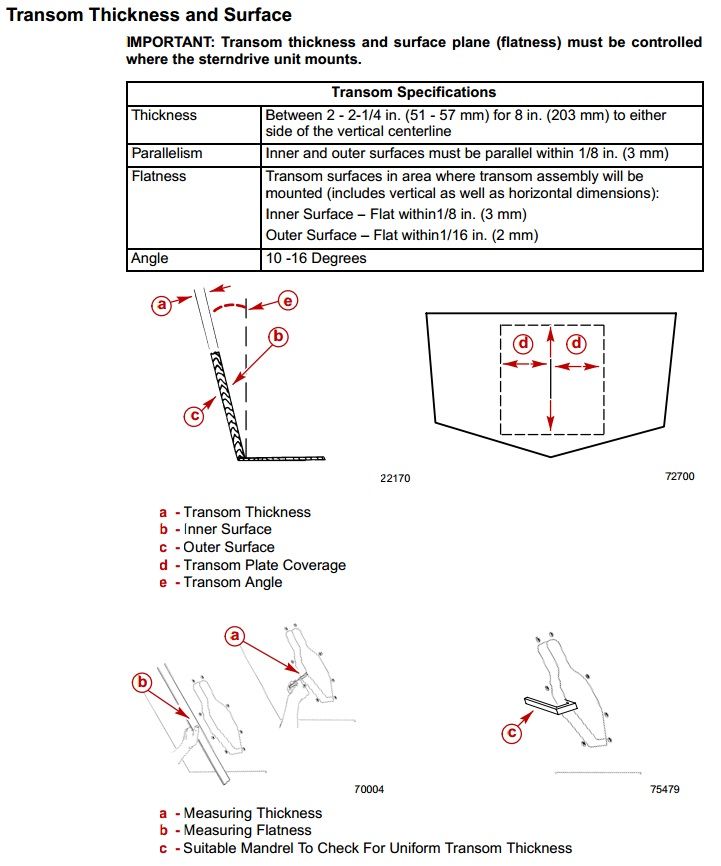

Heres a question for the group: I could cut the mounts from the red line on back and save probably 30 lbs of weight. I guess I was still in my OMC frame of mind. Do you think all that wood is unnessessary? I'm adding 25 horsepower not 500. I think it can go but I'm not an engineer.
Also for the Merc gurus out there, how critical is the thickness of the transom? I know it has be the same within a close tolerance and the book says up to 2.25 inches thick. According to my calculations, I'm going to be in the 2.35 range by the time I'm done adding my 2 layers of 1708. I could grind the top layer of the transom off too. The book says that tolerance is only for 8" around the keyhole suggesting that beyond that, it doesn't really matter. Looking at my donor vessel, I can believe that. I just didn't get a good enough squeeze with the PL. what do you think?

Re: 1985 Seaswirl Tempo 17 floor replacement turning into something bigger.
It is called flatness and parallelism.....
The transom MUST be in factory specs.....You should shoot for 2 inches....I believe the manual calls for 2 and 1/8? Please check the Merc factory manual. There are tolerances with the amount of thread on the studs of the outer plate, but you cannot be too thick or the studs will not be long enough to go through the transom. You will have steering arm issues.
The keyhole must be exactly the same all the way around or your transom will leak. (this is called parallelism)
it must be perfectly flat on both sides.....and it also must be of the exact thickness all the way around the hole.

I would not mess with transom thickness. I've read too many threads where folks had transoms of the wrong thickness or that weren't uniform in thickness and it causes nothing but headaches. I'd get the transom within specs now, rather than find you have to pull the outdrive, transom shield and engine later on.

Ok, I'll shave some off the inside of the transom to keep it under 2.25 inches. UGH. Didn't want to do that but oh well :)
