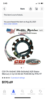

Interesting. I just don’t see any signs of anything getting wet. I wasn’t aware of a voltage difference in stators. When I suspected a bad stator and pulled out the old one, it was black. I just replaced with what I read was the CDI replacement. It is not black, and not really red either
