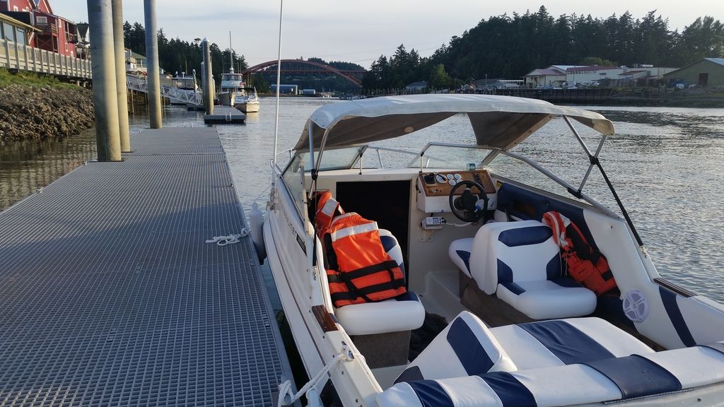

The Maiden Voyage
We launched in the local salt pond and started our maiden voyage. The engine started up right away, and we put her right in the water (see the picture below at the dock). Now, this is where to first issues begin.
As some of you may or may not know, the Volvo Penta 270 outdrive doesn't have an actual trim, just a drive lift. Therefore, it can either be all the way down or all the way up. Attempting to use it in any other position in reverse will cause it to bounce, unbeknownst to me. This particular pond gets very shallow and requires knowledge of the channels to successfully navigate it. We we able to get away from the dock, and took it to a deeper part of the pond to see what kind of power it had. She ran beautifully and we were cruising across the pond celebrating our purchase.
That's when it all starting going bad. We slowed down and started navigating through the channels. That's when we noticed water in the stern seating area coming up through the floor. Not only was it there, but it came all the way up to the mouse hole in the cuddy. Yikes. The engine was having trouble staying on. So, we were able to get to a dock to offload people and equipment, and decided to make an attempt to get it back to the original dock about 400 feet away. There really wasn't a lot of danger because of how shallow the pond is, but it was difficult nonetheless. We ended up getting it out, and while on the trailer did a thorough inspection in an attempt to find the culprit.
The bad news: the transom seal was cracked at the bottom of the outdrive, and was pouring water out of it. We got it back home and left the trailer jack propped up on blocks overnight to allow it to drain.
