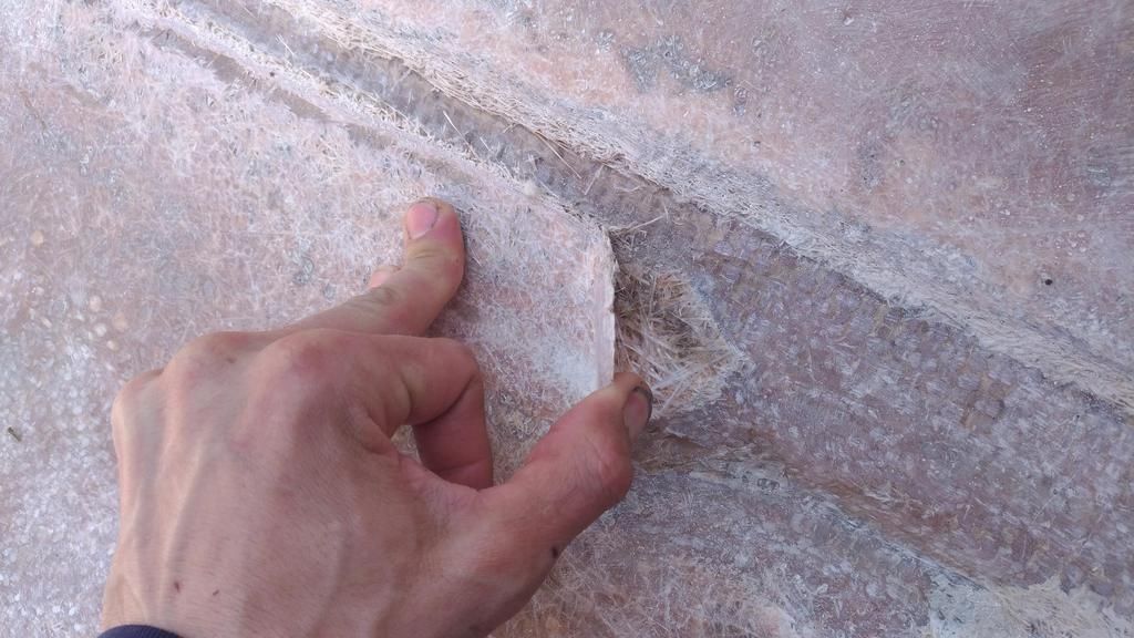

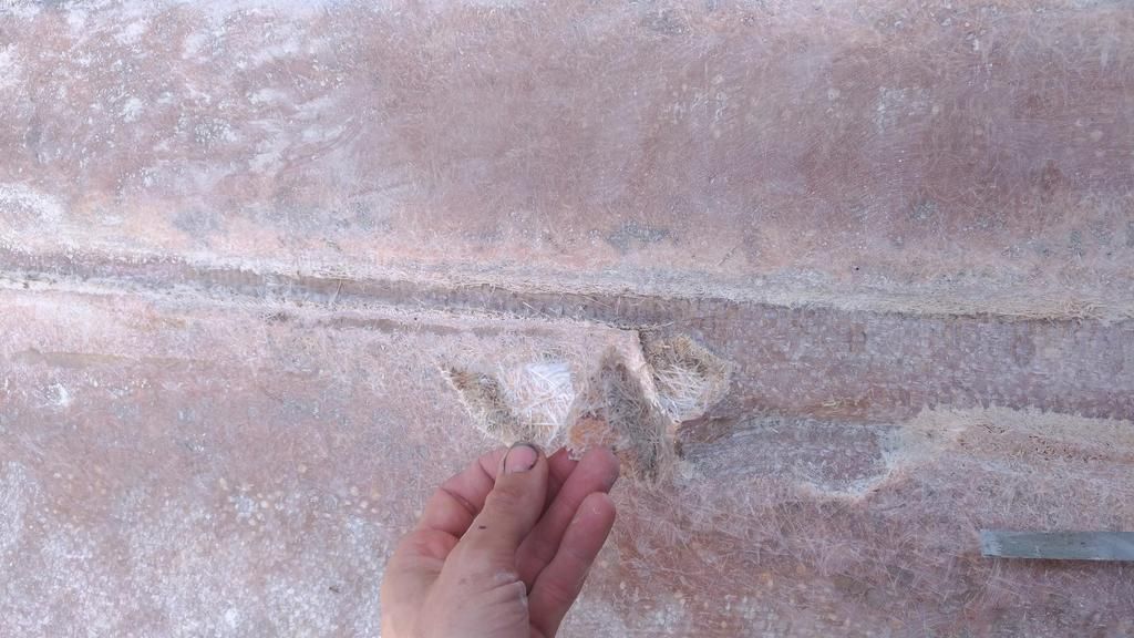

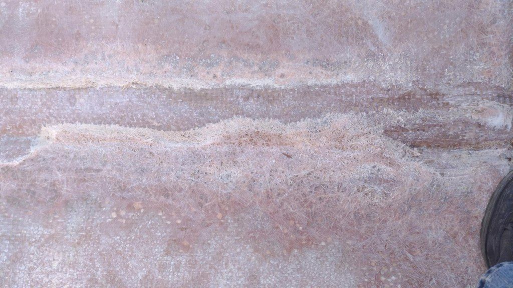

As i am looking through the pile of guts that came out of the boat a month ago, it seems from factory the tabbing and entire method of the factory stringer install complete with the bulkhead and deck was all CSM, there is no other detectable weaving in the layers other than csm ,
The only other different glass in the boat is in the hull where i had to grind out the csm down to the roving to get to solid material.
So with the factory job being ultra sub standard but not having busted in half, I would imagine I can do csm-18oz roving-csm-roving and that would be good for the stringers and bulkheads. Cover bottom side of the deck with 1oz csm and use the 1.5oz csm to stick the deck to the hull and some 2oz cloth to coat the deck from port to starboard to make it nice and smooth and a bit more strength? (Using 5/8 exterior spruce for the deck and the stringers and bulkheads are 3/4 DougFir)

When it hasn't failed, most of the time you just need to rebuild it the same way it was done to begin with, adding roving or 1708 will be a bonus, and either will work.
​Cloth doesn't help much on strength, but may give you a smoother surface if that's what you want, the cost is high though.
