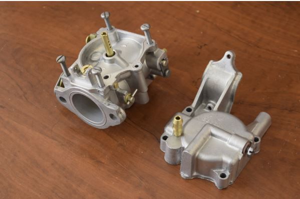

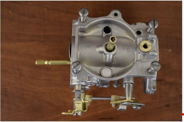

Sounds to me as though the slow speed circuit is still dirty.
Don't recall this carb off hand but there should be a brass pick-up tube in the center sticking down into the bowl. Does this tube also have the small tube inside it? If so that small tube is the slow speed pick-up. It needs to be very clean or you will have problems. Ran a 18hp Evinrude that I had trouble with and had that carb apart 3 times before it was clean enough but once it was done it ran great.

Agreed you have issues in the carburetor.----Did you remove the threaded high speed jet found in the carburetor bowl, yes or no.

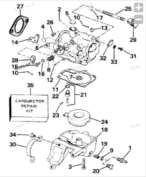

OR...you could have an air leak into the crankcase (bad seals). But make sure the carburetor is right before going there. The retainer should be visible as you look at the front of the carburetor. It is merely a friction device to keep the needle from spinning. There is also a seal, called a "bearing" that goes deep in the hole the needle threads into. For whatever it is worth, I have the same motor, and my slow speed needle runs considerably further open than the "normal" 1-1/2 turns out. But it runs perfect at whatever it takes.

No. I attempted but I need to get a special screwdriver.
I can blow threw the towel in the middle of the bowl and air flows threw the high speed orifice. I will order a replacement and tool to remove.

F-R After putting the new retainer and plastic bearing from the rebuild kit on the needle I have to keep the low speed adjustment needle seated tightly.
