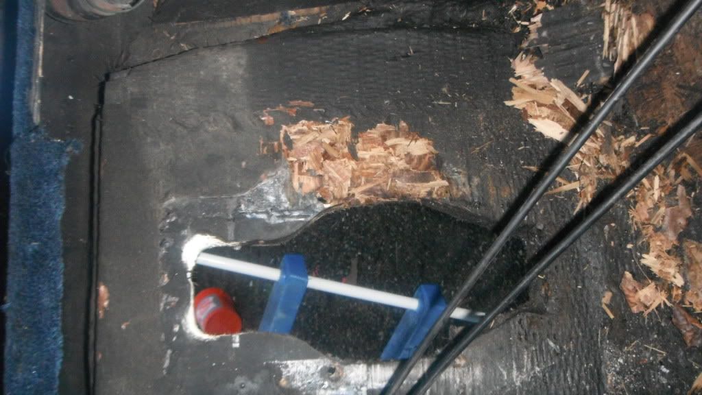

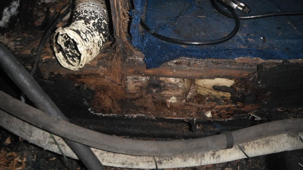

I was able to work on the boat this weekend and pulled the transome plate off and found out the lower part for thetransome were the bell housing mounts is cracked so now I have a question can this be fixed and if so how would I go about doing this here is some pics of what it looks like and a pic of the boat it self.

hi......century....
wow.....first off..... i have an account with comp one.....great place....and comp one is huge.....they make us comp look like puppies
.however if the quantity is too much .... there is a place called fiberlay in your area.....fiberlay is a main supplyer for the states and will even ship to your door.
ok....from what i can see....you have a fubar-ed repair.
let me explain....
post 9 pic one.......some DOLT used OSB board for a transom repair.....chip board...(what an idiot)
post 18..... pic one.....that crack looks suspiously like a omc conversion kit has been improperly installed.....that is why the osb is there and that is why the huge crack...
this is a failed omc conversion due to the improper materials used.
but all is not lost bud. you will just have to do a few more steps.
i am torn between suggesting that you rip out the insert key hole or just pretend the crack isnt there till later.
what i would like you to do....is ......see if you can move the bottom of the keyhole......can it be pushed back into proper position with out much force?.....is so..... just leave the crack alone till later.
if it is really tough to push back into proper shape....then you will have to cut away the loose portion.
(keep the cut out)
this is so the new transom wood can sit flush against the transom skin.
pick one of the two ways....and just dont worry about the out side for now.
install your new transom core as usual....(see the link im my sig for transom instalation)
make sure when you clamp the new transom in.....you really clamp it well....
ok....after its in and cured then you can glass in the back missing portions using alternating csm and 1708 layers till you have the correct thickness......then gellcoat that.....and cut your key hole.
if you leave the bottom half of the cracked area....install the new transom as usual....
then after its cured.....die grind out the crack.....fill with pb.... and add a layer over the crack of csm....and gellcoat.....then cut your keyhole.
remember......the key to a sucessful i/o transom is flatness and parellelism.....so when you are glassing and gellcoating the exterior....make sure they are flat !

Thank you oop's for all the info I think that I can pop that piece back in place and I will proceed with the transom repairs. I did'nt get much time this weekend due to me working on a friends boat but next week and weekend I'll get more time on it.
