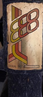

Hello all, I'm looking for a water pump for m 1981 Sea Ray. The outdrive has been replaced before I got the boat, previous owner said he locked up the old one. Any rate, I'm not 100% sure of the year or what water pump to purchase. Nearest boat shop is 65 miles away and talking to them on the phone makes you feel rushed.
Boat is a 1981 Sea Ray 24 foot cabin cruiser.
Outdrive says it's a MerCruiser 888
I want to replace the water pump because it doesn't seem to be circulating, the engine doesn't pull up water nor spit it out. I've bypassed the outdrive as a test, connected water hose to the hose that connects to the outdrive in the engine compartment, and that seems to flow fine. I've also replaced the water pump on the engine itself.
I've searched for "mercruiser 888 water pump" but that comes up with a bunch of different parts. Just want to make sure I'm getting the right part. Any suggestions?
Thanks.
fordlove
May 22, 2021
12
It's hard to read the serial number off mine, it's either 3520809 or maybe first digit is 8 or 9

I'm not an expert but in searching the 888, it was in production from '71 to '77. The serial number range for them was 3106717 to 4782329. The outdrive would be a MC-1 model. When you separate the halves of the drive, the top of the vertical shaft of the lower half will have a pre-load pin at the top. That would confirm the lower half is MC-1. You will have to order two kits, the Water pump upper housing repair kit # 46-96148A 8 which will include everything except the base. The base kit for MC-1 will be #46-57234T 1 . Those are Mercruiser/Quicksilver part numbers.
