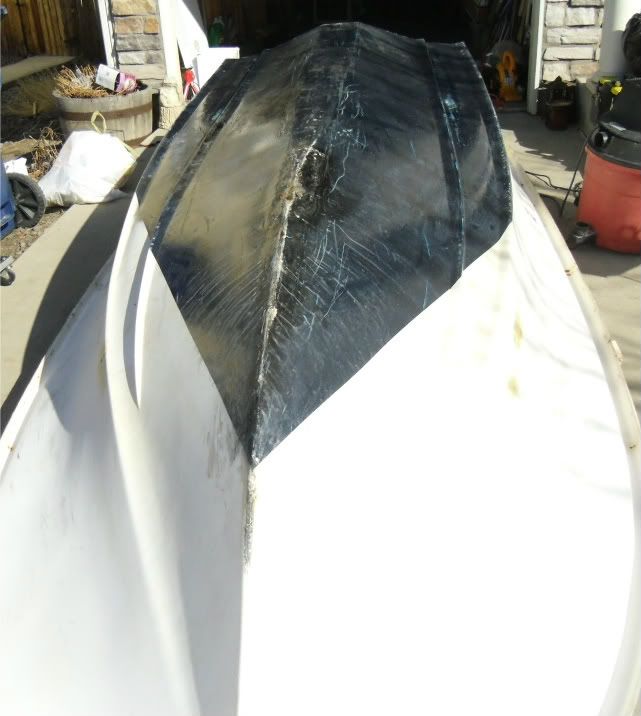

Jb's, pic is bang on....
you boat is not like other boats......the restoration process it totally different, than say a standard run about.
this statment is totally correct.

you will have to do a transom replacement, (yes, your is shot) and you will also have to do some proper hull repairs.

in vid 2 when you were contemplating removing the deck at the floor angle, you were correct.
take a sawzall, and go around the edge of the floor.
remove the floor.
using any tool that you can, i use a maul, remove all the foam that is wet.
the foam will be ok about 6 inches from the bottom of the hull, so you need not worry about what is between the hull and the side gunwhales......just what is wet at the bottom of the boat.
your boat will not have stringers.....just foam.
once the foam is out, the fiberglass hole in the hull can be repaired in the traditional methods.
the transom will have to be cut out in the same fashion. remove the inner skin.
keep the cut out of the splash well.
you cannot consider seacast for this job.
repair transom in traditional methods.
for the wiring space, once the transom is replaced, and the hull repaired,,,use a pvc pipe as the wiring tube.
when re installing the deck......you will need to get the deck to proper height.
this will mean you will need to build a stringer like system, or even plastic blocks to get the deck to proper height for glassing.
once height has been achieved, glass it in.....
you will need several pigeon holes or holes in the deck to re foam the boat.
this link will help you with deck replacement and foaming.
http://forums.iboats.com/showthread.php?t=522237&highlight=fiberglass+deck+foam+hull
i would strongly suggest that you gellcoat in the new deck....
