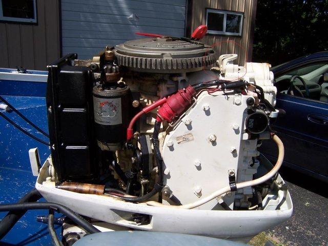

The pictures below show both sides of the motor. One side shows the big red plug you may be referring to. The other one shows the connections of the what I believe is the throttle and cold start cables. Both of which i need to remove before getting the engine off.
BonairII
Jun 7, 2011
2,727
Re: 1979 StarCraft with a small area of transom rot
Yup...disconnect the red plug. The harness is held in place at the front of the motor. Just take the clamp off where the harness enters the motor in the front.
Unhook the controls. There is a rubber plug where the control cables enter the motor.

Once again here is a picture. The arrows on the right show where the cables are coming into the engine. The arrows on the left show the only place I see thus far to remove the cables.
BonairII
Jun 7, 2011
2,727
Yup...remove the cables where they attach to the throttle arm etc. There is also a small clamp that holds both control cables. The clamp is halfway between the cable ends(where your red arrows point) and the rubber plug at the front of the motor.
