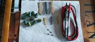

I just bought this stuff
To make a dva , only need one of each but minimum buy is 10 or 20 , whole lot cost about 12 bucks , as opposed to 80- 100 to buy one .🙂

I bought this:
Will that do the same thing?
Yep thats pretty much what Im wanting , damn ,I didnt see one for that price tho 🙂. I bought a little box to put the components in but the capacitor is bigger that I expected and wont fit in the box .
